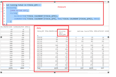

1st row value should be blank, 1st value should be at 2nd row place etc..
1st row value should be at 2nd row value place
2nd row value should be at 3rd row value place
3rd row value should be at 4th row value place.
i have tried with earlier function
like calculate(cal running total in FISCAL_QTR measure,
filter( tablename, fiscal_qtr = fiscal_qtr) but not coming output...earlier(fiscal_qtr) function can not be used for output of measure cal column. could you please help on this requirement.

i have tried with below dax
test2 meas =
CALCULATE([Cal running total in FISCAL_QTR],
FILTER('FISCAL CALENDAR', 'FISCAL CALENDAR'[FISCAL_QTR]= 'FISCAL CALENDAR'[FISCAL_QTR]
// CALCULATE( [Cal running total in FISCAL_QTR],
// FILTER('FISCAL CALENDAR', 'FISCAL CALENDAR'[FISCAL_QTR] = FIRSTNONBLANKVALUE('FISCAL CALENDAR'[FISCAL_QTR],'FISCAL CALENDAR'[FISCAL_QTR])
// MAXX(
// FILTER('FISCAL CALENDAR', 'FISCAL CALENDAR'[FISCAL_QTR] = 'FISCAL CALENDAR'[FISCAL_QTR]
// 'FISCAL CALENDAR'[FISCAL_QTR]<'FISCAL CALENDAR'[FISCAL_QTR]
// ),[Cal running total in FISCAL_QTR])
data:
i have got below dax and trying samething but not working out
