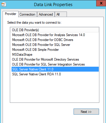

  • This brings up the Data Link Properties Window
    • I click on SQL Server Native Client 11.0
    • I click on Next

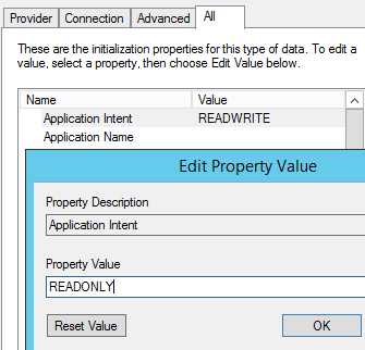

  • I then click on All, where it says Application Intent, it will default to READWRITE
    • NOTE: This is the IMPORTANT part where I want to make sure that it will use the Read-Only replica or secondary replica
    • I clicked on Application Intent and then clicked on Edit Value
    • I then clicked on Ok to complete the changes
  • And then I clicked on Ok again.

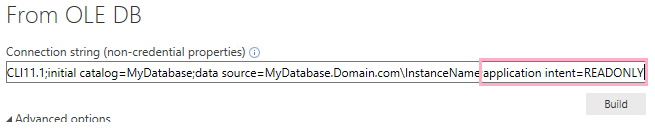

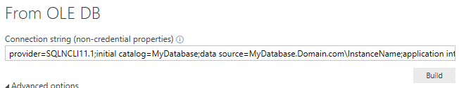

  • I can now see my connection string built for me
    • NOTE: If I scroll across I can see and confirm that I have set the Application Intent to ReadOnly
    • NOTE: Make a copy of the connection string above. This will be used when creating the data source in the On-Premise Data Gateway.

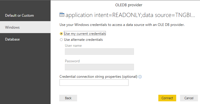

  • I was then prompted for the OLE DB Provider credentials.
    • As far as I understand this is so that the credentials are stored separately from the connection string and not stored in clear text.
    • I selected Windows and then "Use my current credentials"
    • I then clicked Connect.

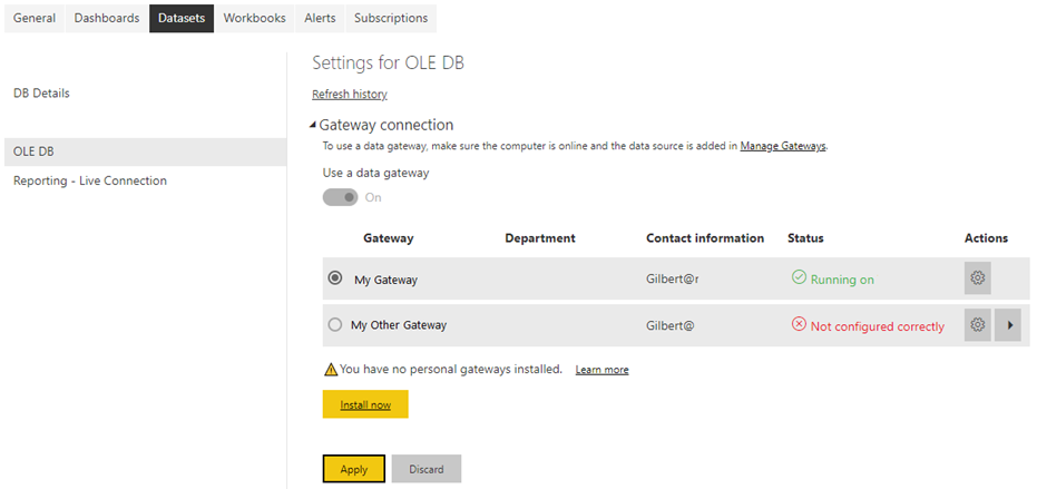

  • I then went into my App Workspace where I had uploaded my PBIX, then into the settings and configured it to use the Gateway.
    • I then clicked Apply.
  • I tested the refresh and it successfully refreshed
