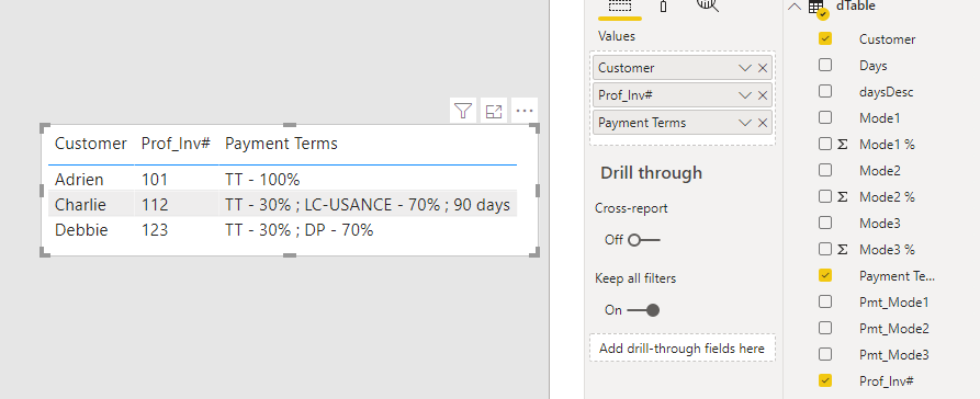

He creado el campo [Términos de pago] en Power Query que puede usar en el informe de la siguiente manera:
    Source = Table.FromRows(Json.Document(Binary.Decompress(Binary.FromText("i45WMjQwVNJRckwpykzNAzJCQoCEoYGBKpBSwMCxOkANhkZAtnNGYlFOZipMhzGKBh9n3dBgRz9nVyDbHCxjaQDRa2QM5LikJiWha3UJgKtFsi4WAA==", BinaryEncoding.Base64), Compression.Deflate)), let _t = ((type text) meta [Serialized.Text = true]) in type table [#"Prof_Inv#" = _t, Customer = _t, Pmt_Mode1 = _t, #"Mode1 %" = _t, Pmt_Mode2 = _t, #"Mode2 %" = _t, Pmt_Mode3 = _t, #"Mode3 %" = _t, Days = _t]),
    replacedSpaceforNull = Table.ReplaceValue(Source," ",null,Replacer.ReplaceValue,{"Mode1 %", "Pmt_Mode2", "Mode2 %", "Pmt_Mode3", "Mode3 %", "Days"}),
    mergeMode1 = Table.AddColumn(replacedSpaceforNull, "Mode1", each Text.Combine({[Pmt_Mode1], [#"Mode1 %"]}, " - "), type text),
    mergeMode2 = Table.AddColumn(mergeMode1, "Mode2", each Text.Combine({[Pmt_Mode2], [#"Mode2 %"]}, " - "), type text),
    mergeMode3 = Table.AddColumn(mergeMode2, "Mode3", each Text.Combine({[Pmt_Mode3], [#"Mode3 %"]}, " - "), type text),
    mergeDaysDesc = Table.AddColumn(mergeMode3, "daysDesc", each if [Days] <> null then Text.Combine({[Days], "days"}, " ") else null, type text),
    mergePaymentTerms = Table.AddColumn(mergeDaysDesc, "Payment Terms", each Text.Combine(List.Select({[Mode1],[Mode2],[Mode3], [daysDesc]}, each _ <> "" and _ <> null), " ; "), type text),
    pctDataTypes = Table.TransformColumnTypes(mergePaymentTerms,{{"Mode1 %", Percentage.Type}, {"Mode2 %", Percentage.Type}, {"Mode3 %", Percentage.Type}})
    pctDataTypes
Pegue esto en una consulta en blanco con Advanced Editor para que pueda seguir mis pasos.
Obtengo la siguiente salida que, por supuesto, se puede filtrar según lo requiera:
