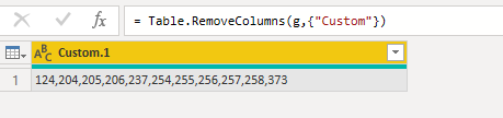

v-frfei-msft
Hola @kcummins ,
Consulte el código M como se indica a continuación.
    Source = Table.FromRows(Json.Document(Binary.Decompress(Binary.FromText("i45WMjQy0VEwMjDRNTIwAzKMzYGEKZBnaqGjYGxurBQbCwA=", BinaryEncoding.Base64), Compression.Deflate)), let _t = ((type text) meta [Serialized.Text = true]) in type table [Column1 = _t]),
    #"Changed Type" = Table.TransformColumnTypes(Source,{{"Column1", type text}}),
    #"Split Column by Delimiter" = Table.SplitColumn(#"Changed Type", "Column1", Splitter.SplitTextByDelimiter(",", QuoteStyle.Csv), {"Column1.1", "Column1.2", "Column1.3", "Column1.4", "Column1.5"}),
    #"Changed Type1" = Table.TransformColumnTypes(#"Split Column by Delimiter",{{"Column1.1", Int64.Type}, {"Column1.2", type text}, {"Column1.3", Int64.Type}, {"Column1.4", type text}, {"Column1.5", Int64.Type}}),
    #"Transposed Table" = Table.Transpose(#"Changed Type1"),
    #"Split Column by Delimiter1" = Table.SplitColumn(Table.TransformColumnTypes(#"Transposed Table", {{"Column1", type text}}, "en-US"), "Column1", Splitter.SplitTextByDelimiter("-", QuoteStyle.Csv), {"Column1.1", "Column1.2"}),
    #"Changed Type2" = Table.TransformColumnTypes(#"Split Column by Delimiter1",{{"Column1.2", Int64.Type}}),
    #"Added Custom" = Table.AddColumn(#"Changed Type2", "Custom", each if[Column1.2] = null then [Column1.1] else [Column1.2]),
    #"Removed Columns" = Table.RemoveColumns(#"Added Custom",{"Column1.2"}),
    #"Changed Type3" = Table.TransformColumnTypes(#"Removed Columns",{{"Custom", Int64.Type}, {"Column1.1", Int64.Type}}),
    #"Added Custom1" = Table.AddColumn(#"Changed Type3", "Custom.1", each List.Numbers([Column1.1],[Custom]-[Column1.1]+1)),
    #"Expanded Custom.1" = Table.ExpandListColumn(#"Added Custom1", "Custom.1"),
    #"Removed Columns1" = Table.RemoveColumns(#"Expanded Custom.1",{"Column1.1", "Custom"}),
    #"Added Custom2" = Table.AddColumn(#"Removed Columns1", "Custom", each 1),
    #"g" = Table.Group(#"Added Custom2", {"Custom"}, {{"Custom.1", each Text.Combine(List.Transform([Custom.1], (x) => Number.ToText(x)), ","), type text}}),
    #"Removed Columns2" = Table.RemoveColumns(g,{"Custom"})
    #"Removed Columns2"
Community Support Team _ Frank
