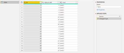

Mesa:

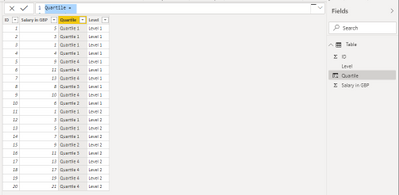

Puede crear una columna calculada como se muestra a continuación.
Quartile =
var _med =
MEDIANX(
    FILTER(
       'Table',
       [Level]=EARLIER('Table'[Level])
    VALUE([Salary in GBP])
return
SWITCH(
    TRUE(),
    [Salary in GBP]<0.85*_med,"Quartile 1",
    [Salary in GBP]>=0.85*_med&&[Salary in GBP]<0.95*_med,"Quartile 2",
    [Salary in GBP]>=0.95*_med&&[Salary in GBP]<1.05*_med,"Midpoint",
    [Salary in GBP]>=1.05*_med&&[Salary in GBP]<1.15*_med,"Quartile 3",
    [Salary in GBP]>=1.15*_med,"Quartile 4"

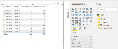

Resultado:
