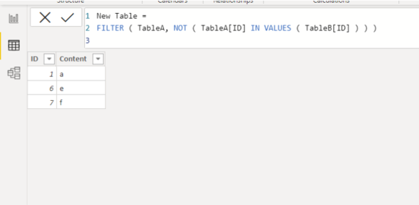

Nueva tabla =
FILTER ( TableA, NOT ( TableA[ID] IN VALUES ( TableB[ID] ) ) )

Nueva tabla =
