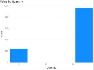

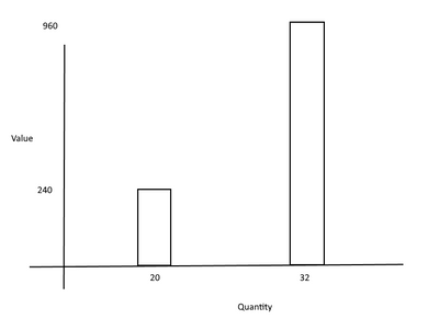

Gráfico de destino [Salida requerida]

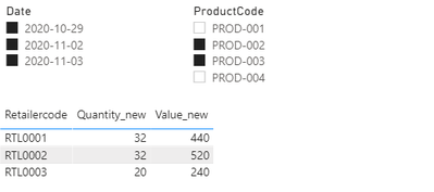

Holaamalsp_ha,
Estos son los pasos que puede seguir:
1. Cree una columna calculada.
Quantity_new =
CALCULATE(SUM('Table'[Quantity]),ALLEXCEPT('Table','Table'[Date],'Table'[ProductCode]))
Value_new =
CALCULATE(SUM('Table'[Value]),ALLEXCEPT('Table','Table'[Date],'Table'[ProductCode]))
2. Resultado.
Puede descargar el archivo PBIX desde aquí.
Liu Yang

What I require is the 20 and the 32 in the x axis and the total for 20 and 32 respectively shown by the bar.
Please check the drawing of the bar chart I posted earlier.

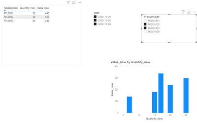

Holaamalsp_ha,
1. Crear medida.
Quantity_new =
CALCULATE(SUM('Table'[Quantity]))
Value_new =
CALCULATE(SUM('Table'[Value]))
2. Resultado.
Liu Yang
Thanks for this, but I need to show this as a chart. The quantity has to go on the x axis and value to the y axis as I have shown in the chart I have given. As far as I know a measure cannot be added to an axis of a chart.
