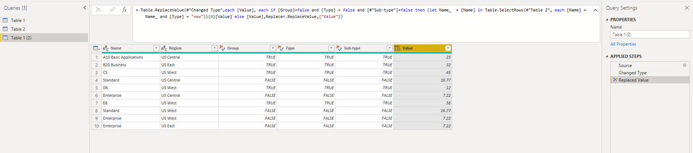

1. Intente reemplazar el valor en el editor de Power Query.
= Table.ReplaceValue(#"Changed Type",each [Value], each if [Group]=false and [Type] = false and [#"Sub-type"]=false then (let Name_  = [Name] in Table.SelectRows(#"Table 2", each [Name] = Name_ and [Type] = "new")){0}[Value] else [Value],Replacer.ReplaceValue,{"Value"})

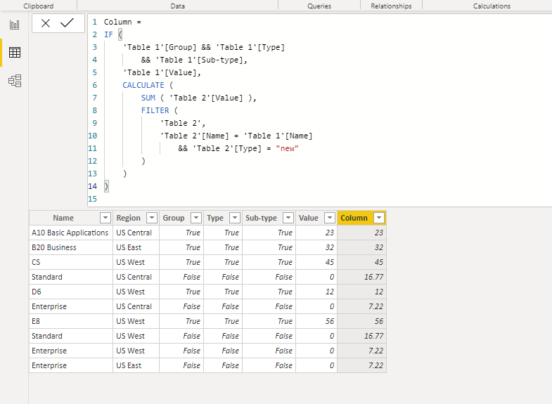

2. O bien, puede crear una columna calculada o una medida en Power BI Desktop.
Column =
IF (
    'Table 1'[Group] && 'Table 1'[Type]
        && 'Table 1'[Sub-type],
    'Table 1'[Value],
        SUM ( 'Table 2'[Value] ),
        FILTER (
            'Table 2',
            'Table 2'[Name] = 'Table 1'[Name]
                && 'Table 2'[Type] = "new"

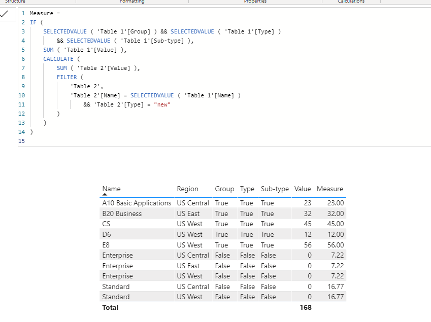

Measure =
IF (
    SELECTEDVALUE ( 'Table 1'[Group] ) && SELECTEDVALUE ( 'Table 1'[Type] )
        && SELECTEDVALUE ( 'Table 1'[Sub-type] ),
    SUM ( 'Table 1'[Value] ),
        FILTER (
            'Table 2',
            'Table 2'[Name] = SELECTEDVALUE ( 'Table 1'[Name] )
BTW, archivo .pbix adjunto.
