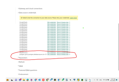

i cant connect power bi with postgres.database.azure :
error :
Failed to update data source credentials: An error happened while reading data from the provider: 'Could not load file or assembly 'System.Runtime.CompilerServices.Unsafe, Version=5.0.0.0, Culture=neutral, PublicKeyToken=b03f5f7f11d50a3a' or one of its dependencies. The located assembly's manifest definition does not match the assembly reference. (Exception from HRESULT: 0x80131040)'Hide details
Activity ID: 8f9a1a82-6633-4d2c-b8fb-1ef4bf852440
Request ID: 2d20805c-1978-9581-f087-972f4d988dfb
Status code: 400
Time: Mon Sep 11 2023 01:48:33 GMT+0300 (Arabian Standard Time)
Service version: 13.0.21509.81
Client version: 2309.1.15569-train
Cluster URI: https://wabi-east-asia-b-primary-redirect.analysis.windows.net/

The same issue manifests for me and I am not using a gateway (I shouldn't have to, as my Postgres instance is deployed on the cloud), so I don't think this is the problem. Btw, on Power BI Dekstop it works, the problem manifests only in Power BI Service, when you publish the report.

I am having the same error while trying to set up "auto refresh" in PowerBI Services yesterday, and still can't find a solution yet.
My PowerBI Desktop has no problem connecting and importing tables from this Azure Database. Also, after I clicked "Refresh" in PowerBI Desktop, the tables are still updated with latest data.
However, after publishing it to PowerBI Services, it shows the same error as yours while I try to edit the credentials.
Couple months ago, I also had trouble setting up "auto refresh", which I cannot recall what the errors are. I had to ask my Database Admin to set up permission in Azure Portal as instructed in this Microsoft document: https://learn.microsoft.com/en-us/power-bi/connect-data/service-admin-troubleshooting-scheduled-refresh-azure-sql-databases
I am asking him to double check this setting again, but he is on vacation for a week. You can try that and let me know if it works tho.
