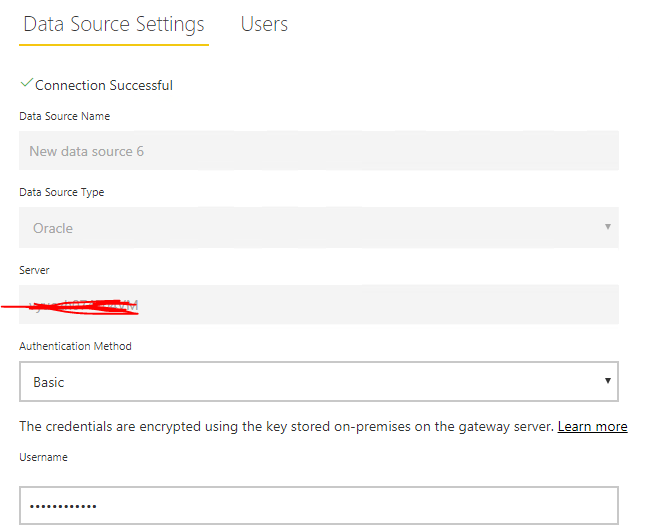

- RSPPBI8 years agoRegular Visitor
I am not sure what you mean...
How do you make 4 times connection to the same Oracle database
I try to do this in the Gateway, via Add Source, which method(s) do you use?
Someone also sugested to use different aliases in the tnsnames.ora file.
Have you experience with that and what should I fill in iin this file, can you give me an example?
- v-frfei-msft8 years ago
Hi RSPPBI,
Based on my test, all the four kinds of server names could be added in the gateway. Please notice, only the gateway is installed on the same machine with Oracle, the localhost could be used.
Please refer to the pictures as below.
Frank
