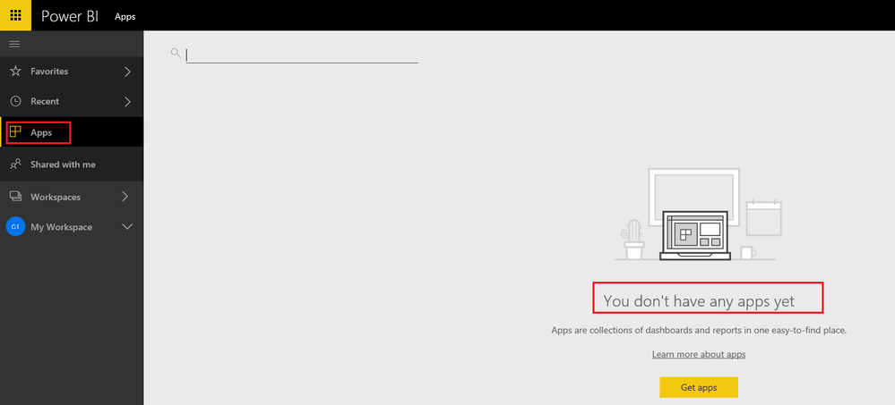

    According to this article, unpublish an app will remove the app from Microsoft AppSource and make it inaccessible by all end users.
    I also verified that the unpublish app feature works all fine for me. After I unpublish the app, it will disappear from all end users' Apps tab on Power BI service.
    Before Unpublish APP
    After Unpublish APP
    And if the end users try to access it from the original app URL, they will get the following error. :smileyhappy:
