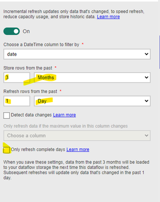

Use the biggest partition size you can get away with.  Your choices are Day,Month,Quarter and Year.
I would start with Day and check how many rows you get per partition. If not too many you can switch to Month.
Please help me understand this step. My aim was to get data for the past 90 days - so period being = 9 April to 9 July or so. The current dataflow has data for last 30 days meaning - 9 June to 9 july.
What am i supposed to be inputting on the incremental refresh because the refresh rows days can't be higher than the store rows days.
And if i am successful to even bring all the past 90 days somwhow, i still have to figure out a way to keep that as a rolling 90 day.
Thanks and i appreciate all your help.
Set it to refresh 1 day and store 10 days. Then evaluate the refresh log to see how many rows are in each partition.  If there are substantially fewer than 8M rows per day then you can change your settings to 1 day and 3 months.
You will get the rolling 90 days automatically (plus some extra days to complete the months, as the actual month partitions will include not three but four months).  You could change your setting to 1 day and 90 days but that would mean you would have 90 partitions. Only do that if necessary.

yes, looks like your day partitions processed fine.  Do not add your own filters for the range, and do not use any transforms that break query folding.

uncheck the "only complete months" box.

Not sure if i mentioned before but the source data does run on a 2 day delay (including today), meaning today i only have data on that table till 08/12/2024
And since i kept the inc refresh at refresh rows from past 1 day since refresh date - it will not get any data because it just does not exist.
