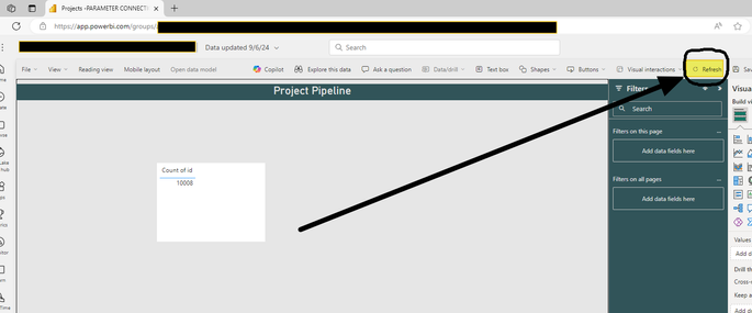

Below: I want to change connection prefix from MySQL.Database to Sql.Database
I ended up doing it by making Source conditional, based off value of parameter, within the Power Query advanced editor.
I'm using the approach below.
let Source =if server= "xerxes" then MySQL.Database("xerxes.corp.brillo.com", "brilloweb_api", [Query="select *#(lf)from products;", ReturnSingleDatabase=true]) else if server = "alexander" then Sql.Database("alexander.corp.brillo.com", "brilloweb_api", [Query="SELECT * FROM products p;"]) else MySQL.Database("xerxes.corp.brillo.com", "brilloweb_api", [Query="select *#(lf)from products;", ReturnSingleDatabase=true]) in Source
