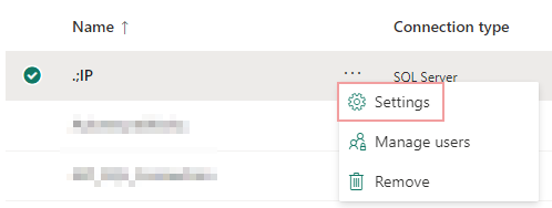

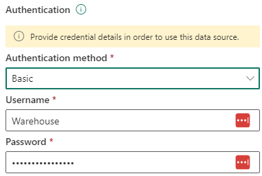

GilbertQ
Hi @srivp07
Please find the details below when you can go into the manage connections gateways section and then find your data source and from there you can then right click and select settings where you can then update the password.
Power BI Blog
Thanks GilbertQ for your response, howerver when I updated password it is locking my oracle account immidiateley. I tested the connection in SQL developer before updating in on premises  Gateway and I logged in successfully and failing to upddate in gateway. Also it shows , gateway configured incorrectly error message. Please help!
