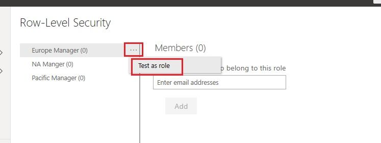

Each report's RLS set up is different. If I go to the Dataset's security settings and click on "Test as role", it always takes me to Report A. This means I can positively confirm that my RLS rules are working for Report A, but how can I do the same for Reports B and C? I even tried publishing Report B, and then immediately going to "Test as role", but it still directs me to Report A.

      i know of 2 options to test RLS on shared dataset.
      First, you can create a tabular visual on shareddataset pbix, containing all columns.When you deploy that PBIX you will have a report which you can use to test RLS, using RLS "test as role" functionality
      Second, is by creating a embedded application (a kind of simulator), which can have input as user email and role id.
