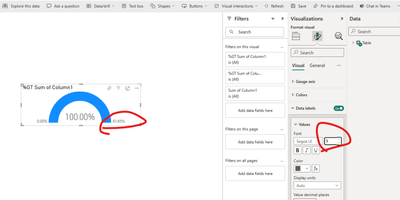

Hi, @DKHUghes55
Thank you very much for your reply. After my testing, there is indeed a problem with the display, as shown in the image below:
The main reason is that there is not enough space to display these data labels. You can make the Gauge visual look normal in one of the following ways:
1. Resize the visual
2. Adjust the Data label font size
If it does not help, please provide more details with your desired output and pbix file without privacy information (or some sample data) .
