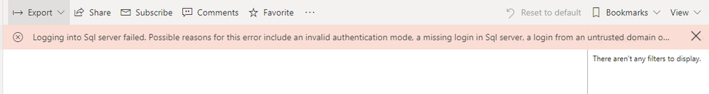

It is currently configured with SQL server as data source type, which works when the data in the report is loaded in Import Mode. There is no separate option for Amazon RDS, only for AWS Redshift.

That's what we thought, but that resulted in the error message from my first post.
When ticking the SSO box as you mentioned earlier we get a different error by the way: "This report couldn't access the data source. Contact [my name], the author, to have it fixed"

What happens if you use a SQL Server Account for authentication?- fabbimk6 years agoFrequent Visitor
It does not seem to make a difference whether Windows authentication or basic SQL server account is used. For both it says in the data source settings that the connection is successful, but when opening the report I get the same error message.
