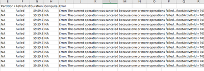

I have a really odd issue with a data flow.
It failed over night and looks like it basically timed out:
The data flow is as simple as it comes, direct load from a set of On Prem DW tables with no ETL. Normal run time is around 30 seconds in PPU so data volume is not massive.
I refreshed it again with SQL Server Profile open and saw nothing reaching it.
The solution I found was to drop the work space out of premium per user to pro. Refresh (which worked) and then restore it to PPU. Everything is now working.
Assume this is related to something in the compute engine but no idea.
Thoughts welcome.
