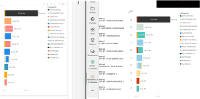

Hi, this does not solve the issue.
I've cleared the caché, deleted the report and re uploaded it, and the issue remains:
Desktop / Online:
The only real solution is re-mapping every color online?
I hate it. It's so uneffficient spending hours doing that.
