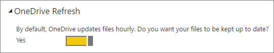

For all of the datasets/reports on Power BI Service I have OneDrive refresh turned on, so I would expect the Reports to update about every hour. Can anyone please tell me why this is not happening?

Hi @DavidSBikes,
I guess you are upload pbix file to onedrive and direct use power bi service to connect this pbix file, right?
If this is a case, onedrive refresh is different as you thought. It only trigger when that source file(pbix) updated. It should be the reason you mentioned why it not refresh when data source(csv files) updated.
Package refresh
This synchronizes your Power BI Desktop, or Excel, file between the Power BI service and OneDrive, or SharePoint Online. This does not pull data from the original data source. The dataset in Power BI will only be updated with what is in the file within OneDrive, or SharePoint Online.
Xiaoxin Sheng
