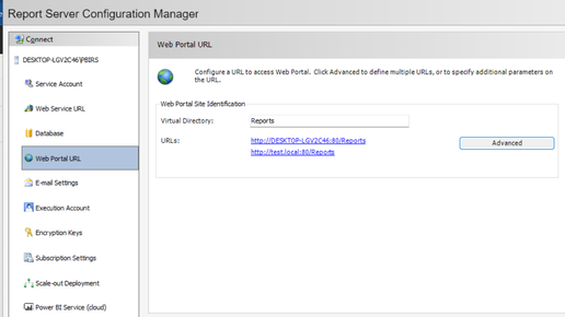

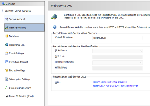

in host file set test.local url for local system ip address 192.168.85.1
in power bi report server configuration set test.local on web service url and web portal url.

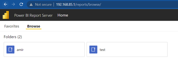

when use IP or desktop name, power bi report server load whiout any problem.

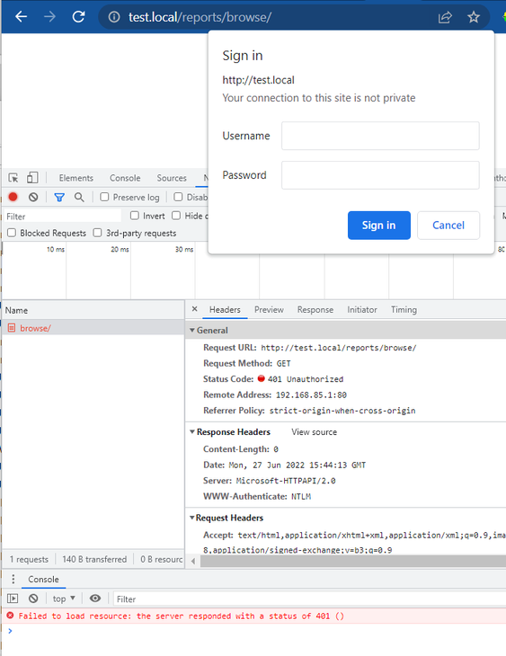

 but when using test.local url hit, authentication popup show and con not login to reprot server whit user name and password.
d_gosbell
This is most likely happening because you are hitting the loopback check.
See the following link for information and 2 methods of fixing this (your hosts entry is similar to a CNAME)
Error message when you try to access a server locally by using its FQDN or its CNAME alias after you...

thanks, but you can see in the last image power bi reprot server is loaded in test.local. The problem is that it does not login with the username and password.
