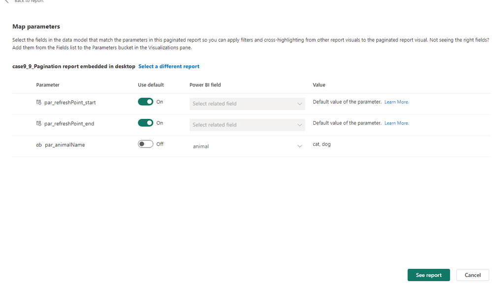

    I started by creating a paginated report
    Parameter Configuration:
    The Availables Values and Default Values for both time filter parameters (Start & End) are None.
    Text type parameter animalName
    It's best to create a dataset specifically for the text type parameter to get the data to avoid problems
    Subquery to get data from the dataset (you can also filter the data with Filters, both work)
    Please ensure that the query parameters are bound correctly
    Uploading paginated reports to the power BI service works fine (be careful to configure the gateway)
    Then use power bi desktop to create the report, here I am using the same data source
    Loading the paginated report visual
    Note that you need to pay attention to the order when adding the paginated report visual
    1. Click on visual first, then add the filter fields (all the fields you want to add to the slicer).
    Select the paginated report you need to add (it has been successfully uploaded to the power bi service and the gateway has been configured and is working properly)
    You need to close the Use default button and select the field you just added in (be careful to keep the data type of the field consistent)
    After adding the slicer, select the options, and then click Apply changes on the paginated report.
    Success changes outcomes
    I also tested that when you use the date slicer (when you select the between type, the value filtered on the later date cannot be added as a filter to the paginated report visual. You can see in the red area that the visual shows data after 4/23/2024).
    Therefore it is not recommended to use the between type
