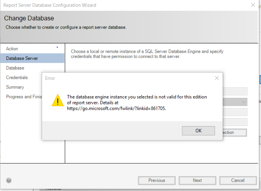

Trying to configure report server to use database engine form sql server 2017 express and eval .
Throws the following error
"The Database engine instance you selected is not valid for this edition of report server"

I installed standered edition eval to test and developer editon as well, both has SQL server agent , up and running . But i still get the same error

yes, of course ! The test connection is successful in the power bi configuration manager . Only when i click next i get the above mentioned error
