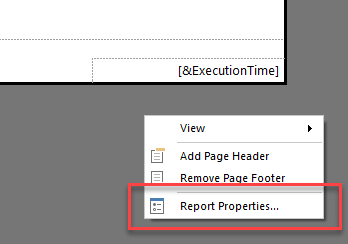

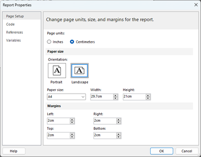

It sounds like you might be changing the orientation in the print dialog.
If you open Report Builder and then right click on the gray area outside the report body you should have an option to see the Report Properties
And in there you can set the orientation and page size and that should save as the default for your report which will apply to both printing and exporting to page based formats like PDF.

That's the solution, thanks d_gosbell.
