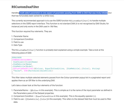

    As you write it, it will return blank when the parameter selects multiple values:
    Single value:
    Blank is returned when multiple values are selected:
    We need to change the query statement to the following using RSCustomDaxFilter:
    EVALUATE
    SUMMARIZECOLUMNS(UserInfo[Age],UserInfo[Income],UserInfo[Name],
    RSCustomDaxFilter(@Username,EqualToCondition,[UserInfo].[Name],String))
    Then when we pass the multiselect parameter, it works:
    You should change the parameters that you need to pass multiple values ​​to use RSCustomDaxFilter to reference these parameters. You can refer to the following blog:
    Chris Webb's BI Blog: Power BI Report Builder And RSCustomDaxFilter (crossjoin.co.uk)

      Hi, Karolina411
      Thank you for your reply. In my last reply is an example, only use this Report Builder function, so that when our parameters select multiple choices, it will be correctly converted into a filter statement that the AS engine can accept.
      You can refer to the following thread, which has the same requirement as yours:
      Solved: Paginated Report - multiple parameter via DAX quer... - Microsoft Fabric Community
      You can see the following discussion about this function:
      Format Query doesn't like RSCustomDaxFilter · Issue #637 · DaxStudio/DaxStudio (github.com)
      You need to use this function and then adjust your DAX query appropriately to support the correct display of content when using multiple values ​​in Report Builder.
      Jianpeng Li
      If this post helps, then please consider Accept it as the solution to help the other members find it more quickly.
      • Karolina411's avatar
        Karolina411
        Icon for Helper V rankHelper V

    Hi, Karolina411
    Thank you for your reply. Your previous PO and PCPlocation work fine, which is good. The query required for your main dataset should be similar to the following:
    EVALUATE
    SUMMARIZECOLUMNS('Providers'[PhysicianOrganization],'Providers'[PCPLocation],  'Patients'[InsuranceType],'DateDim'[Year], 'DateDim'[MonthNameAbbreviation],RSCustomDaxFilter(@PhysicianOrganization,EqualToCondition,[Providers].[PhysicianOrganization],String),
    RSCustomDaxFilter(@PCPlocation,EqualToCondition,[Providers].[PCPLocation],String),
    FILTER(
                VALUES('DateDim'[Year]),
                'DateDim'[Year] = VALUE(@Year)
    FILTER(
                VALUES('DateDim'[MonthNameAbbreviation]),
                'DateDim'[MonthNameAbbreviation] = @Month
    Please note that I also used RSCustomDaxFilter in the main dataset to obtain PO and PCPlocation. Based on my DAX expression, you can continue to add your subsequent measures in SUMMARIZECOLUMNS.
    Here is my demonstration result:
    Jianpeng Li
