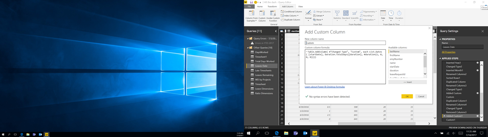

Ok thanks! I copied that code to create a custom column and keep getting errors though...
The only difference is I used a 'duration' column instead of [StartDate] - [EndDate] which has decimal numbers, maybe that could be the problem? Or is my syntax wrong?
Thanks,
Pierre
