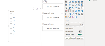

Hi @Vishwamber
You can refer to the following solution.
Step 1: You can create two blank query, then put the following code to advanced editor in power query then apply them.
    Source = Table.FromRows(Json.Document(Binary.Decompress(Binary.FromText("i45WKkk2NDJW0lEqSCwuBlJFhjpFRkqxOhAJE6BIWmJmDlTCWKfIFC5niipnApY2h0ubIZlpBNSnAyKN4dLmqLrN4BIWSBKmWEUNlWJjAQ==", BinaryEncoding.Base64), Compression.Deflate)), let _t = ((type nullable text) meta [Serialized.Text = true]) in type table [TC = _t, Status = _t, plat = _t]),
    #"Changed Type" = Table.TransformColumnTypes(Source,{{"TC", type text}, {"Status", type text}, {"plat", type text}})
    #"Changed Type"
    #"Changed Type" = Table.TransformColumnTypes(Source,{{"TC", type text}, {"Status", type text}, {"plat", type text}}),
    #"Split Column by Delimiter" = Table.SplitColumn(#"Changed Type", "plat", Splitter.SplitTextByDelimiter(",", QuoteStyle.Csv), {"plat.1", "plat.2", "plat.3", "plat.4"}),
    #"Changed Type1" = Table.TransformColumnTypes(#"Split Column by Delimiter",{{"plat.1", type text}, {"plat.2", type text}, {"plat.3", type text}, {"plat.4", type text}}),
    #"Unpivoted Columns" = Table.UnpivotOtherColumns(#"Changed Type1", {"TC", "Status"}, "Attribute", "Value"),
    #"Removed Columns" = Table.RemoveColumns(#"Unpivoted Columns",{"TC", "Status", "Attribute"}),
    #"Removed Duplicates" = Table.Distinct(#"Removed Columns")
Step 2: put the value of query(2) to slicer.
then create a measure
Measure = IF(COUNTROWS(FILTER(VALUES('Query1 (2)'[Value]),CONTAINSSTRING(SELECTEDVALUE(Query1[plat]),[Value])))>0,1,0)
Then put the measure to the table visual filter
Output
Best Regards!
Yolo Zhu
