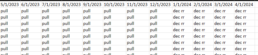

Rolling 12 months forecast (power query) , setting month equal to previous
Looking to create rolling forecast where 2023 is pulled from the forecast database and 2024 months are just set equal to December. Is there a way to do this in power query, w/o using DAX? I have figured out how to have dymanic columns tacked on as the months cycle through, but not sure how to go about pulling in the dec RR for the now empty 2024 columns.

thanks! if i have data to the left can i just change [column1] to whatever column number it will then be or will that break things?
You shouldn't have to change anything other than possibly the data type transformations. If you are seeing errors, I'd suggest deleting the data type transformation steps and figuring things out from there.
The dates will still be in Column1 of the transposed table.
useruser3
hi thanks! but the "dec rr" would be dynamic number, as in set equal to what the runrate is for december, not text. not sure i'm following this part of it as i see the hardcoded"dec rr"?
Right after spending far to long on this 😁  I think I have a solution however it is going to need 3 sperate query to do so (someone better than me can probably do it in one)
It will take your source data of X number of months remainign in the current year and make it up to a total of 12 Months (so May 2023 to May 2024) and anything in the next year (dynamic so wont need to change each year) put "dec rr" in each cell.
