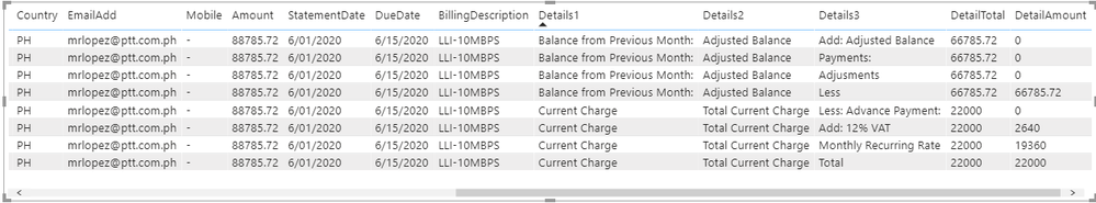

Hi Mariusz,
Thank you for the response. The issue was the Details3 column sort was different from my Data view and Query view sort. I wonder if I have clicked something accidentally as a learner for Power BI. I cannot correct the sort even if I user a custom sort, this will be exported as a CSV file.
My Data and Query View (Correct) Report View
Less Add: Adjuested Balance
Payments Payments
Adjusments Adjustments
Add: Add Adjusted Balance Less
Monthly Recurring Rate Less: Advance Payment:
Add: 12% VAT Add: 12% VAT
Total Monthly Recurring Rate
Less: Advance Payment Total

Hi Eiseln ,
You could add an index column in the query editor. Then sort this column by index in the data tab.
