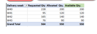

Table C (Col Qty) is requested qty. per week
Table C (Col New Qty). Calculated allocation based on the number from Table B
If the requested qty per week exceeds the qty. in Table B, then the qty. of the last sales order must have an adjustment. And the remaining qty that cannot be covered in the requested week and must be carried over to the following week.
Eg. In Week 40 the requested qty. is total of 228 boxes, but only 200 boxes are available in the inventory. So I can send 200 boxes in week 40 and the remaining 28 boxes in week 41.
3 sales orders in WK 40
WK 40: 1015 - 82 Boxes
WK 40: 1016 - 33 Boxes
WK 40: 1008 - 85 Boxes (origin requested qty. is 113, but can only allocate 85 boxes due to insufficient inventory in WK 40. )
WK 41: 1008 - 28 Boxes
I need to allocate per sales order and per priority and per week as shown in Table C

Yes, that will be okay as long you can provide the output below in DAX, as table C as a result.
I need a detailed overview to coordinate the detailed delivery plan with all the customers.
The pivot table you referring to is only to illustrate the difference between Tables A and C.
- Sales Order
- Item number
- Priority
- Delivery Week number
- Requested Qty
- Allocated QTY
Table A + B is the input to Table C
