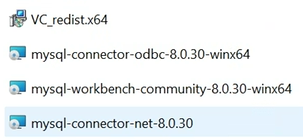

  • Downgraded everything to 8.0.24 (server + connector) and it is fixed the problem.

  • managed to solve the issue by installing mysql-connector-net-8.0.28
