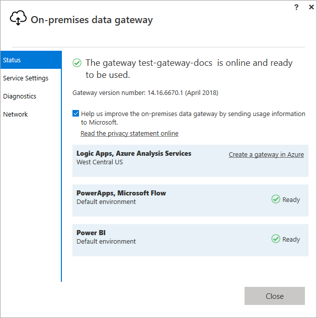

Doing a POC with a customer recently we had an issue installing the gateway in a domain that was different to the Azure tenancy being used.
  1. Domain A - Staff and Azure subs
  2. Domain B - Users and on-premise server hosting
We attempted to install the DG on a server in domain B, and used a user registered in domain A to install the gateway. Everything was successful and could see the correct tenancy IDs in the property files etc, however the gateway could not be located in the Azure sub being used for the POC.
Eventually we installed a DG on a machine in domain A and reused the user and everything worked correctly.
I have read all the documentation & troubleshooting articles and there is no mention of multiple domain issues.
Anyone know if this multi domain setup is supported?

      The issue is with the creation of a gateway in Azure subscriptions. The data gateway was not registered with the Azure subscription. Only when we installed the DG in another domain did it correctly registered.

      In the end I believe everything came down to confusion regarding which identity needed to be used to register the data gateway, that identity needs access to the Azure Subscriptions where you will install the Azure gateway.
