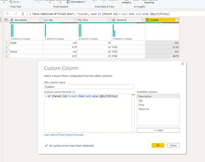

    If you're doing this on Power Query try the following:
    1.  Select the Unit Price columns and go to "Transform" then "Fill down"
    2. Create a custom column and input =if [Parent Id] = null then null else [Qty]*[Price]
      Thanks Anonymous
      Wouldn't that only work if my data was neatly grouped by parent ID and in a convenient order for me? Fill down would give everything the value of the top row wouldn't it?
      My actual data is 5000 rows and the parent rows are going to be spread throughout the data, not at the top and not necessarily anywhere near the child records that need to inherit the unit price
      For instance, if I jumble up the dummy data to be more representative. With 2 parents at the top and the child records in a non consecutive order underneath there would be no way to use fill down?
