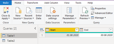

Hi @Anonymous
Attached are an Excel workbook and a PBIX file containing the 2 queries that filter as you require.
The first query loads the Start and End dates.
The 2nd query loads the table of dates/tickets and filters using the dates from the first query.
In the M code in the PBIX file, you will need to change the folder that the file is loaded from.
Query 1 - Load Start and End Dates
Source = Excel.Workbook(File.Contents("D:\temp\bogachev\bogachev.xlsx"), null, true),
Start_End_Table = Source{[Item="Start_End",Kind="Table"]}[Data],
#"Changed Type" = Table.TransformColumnTypes(Start_End_Table,{{"Start", type datetime}, {"End", type datetime}})
#"Changed Type"

Hi @Anonymous
Assuming that your first query is called Periods then you can filter the Close date column in your 2nd query with this
#"Filtered Rows" = Table.SelectRows(PreviousStepName, each ([Close date] >= Periods[Period start]{0} and [Close date] <= Periods[Period end]{0}))

Hello @PhilipTreacy ,
Thank you for your reply. Unfortunately, it didin't work for me. Maybe I do something wrong. Let me explain one more time. I have Excel file with 2 tables as source file. Can't attach files here, but I uploaded it to Google Drive if required
After export table1 looks like:
Table 2 looks like:
What I need to do: I need to filter column "Closed date" of Table2 with dates between "Start" and "End" of Table1.
Is it possible?
