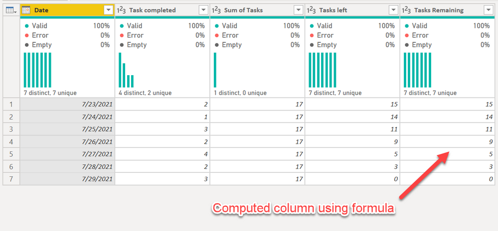

If you are trying to compute the Tasks Left column, see below code, and below explanation on how to get this code into Power Query to test with @THU
    Source = Table.FromRows(Json.Document(Binary.Decompress(Binary.FromText("bc27DcAwCATQXagti59DPIvF/mvEEYlFQXHXPMGtBSwdrTMyQQPeIXtrgLeNmpAOauBIKAcp8KrezjBLpr99i3d1J2GzGkRwfwA=", BinaryEncoding.Base64), Compression.Deflate)), let _t = ((type nullable text) meta [Serialized.Text = true]) in type table [Date = _t, #"Task completed" = _t, #"Sum of Tasks" = _t, #"Tasks left" = _t]),
    #"Changed Type with Locale" = Table.TransformColumnTypes(Source, {{"Date", type date}}, "en-BS"),
    #"Changed Type" = Table.TransformColumnTypes(#"Changed Type with Locale",{{"Task completed", Int64.Type}, {"Sum of Tasks", Int64.Type}, {"Tasks left", Int64.Type}}),
    #"Tasks Remaining" =
        Table.AddColumn(
            #"Changed Type",
            "Tasks Remaining",
            each
                    varDate = [Date]
                [Sum of Tasks] -
                List.Sum(
                    Table.SelectRows(
                        #"Changed Type",
                        each [Date] <= varDate
                    )[Task completed]
            Int64.Type
    #"Tasks Remaining"
However, this will not perform well on larger data sets - anything over a few thousand records. Power Query isn't good at doing table scans. DAX is best for this.

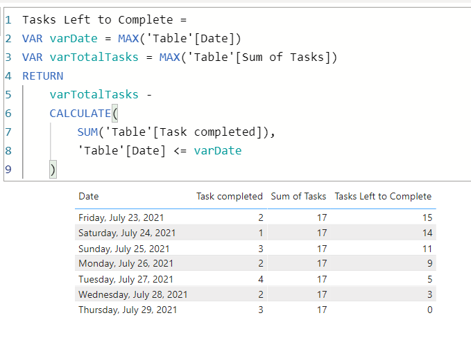

Tasks Left to Complete =
VAR varDate = MAX('Table'[Date])
VAR varTotalTasks = MAX('Table'[Sum of Tasks])
    varTotalTasks -
    CALCULATE(
        SUM('Table'[Task completed]),
        'Table'[Date] <= varDate
That measure will work over millions of records nearly instantly.
