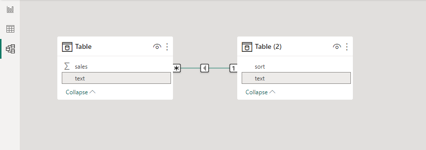

Hi @Anonymous ,
You can create a new table which contains the sorting.
For example, by default, he sorts by number size, I want to customize a sequence, you can do it as follows.
Create a new table.
Sort text column by sort column.
Create a relationship and in general, it is one-to-many.
Replace the text column with the new table, and you will get the result of the custom sort.
Sort a Column with a Custom Order in Power BI - RADACAD
Stephen Tao
Did you read OP? She's using SSAS. You can't just create a table against AS.
