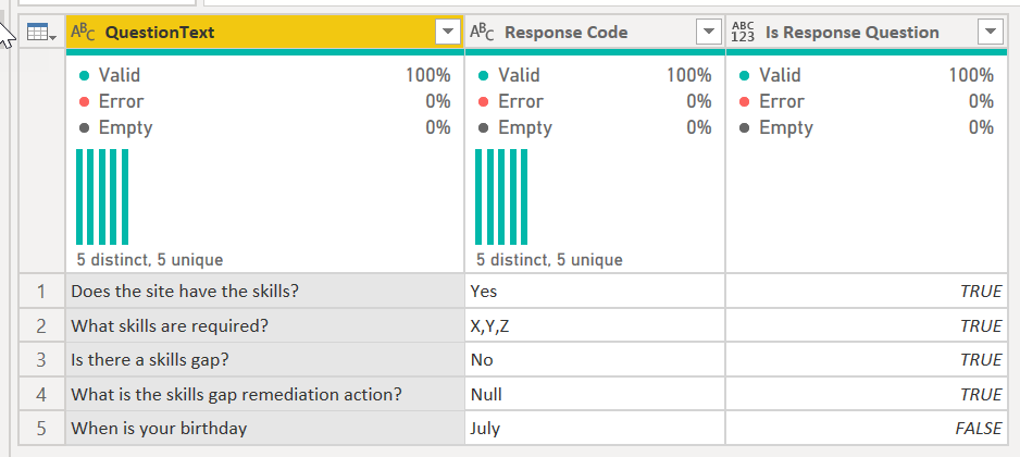

You'll see it returns this:
Just replace true/false with your desired output.
You can add as many things to that list (the thing between the squigly brackets and it will evaulate every question against that list.
