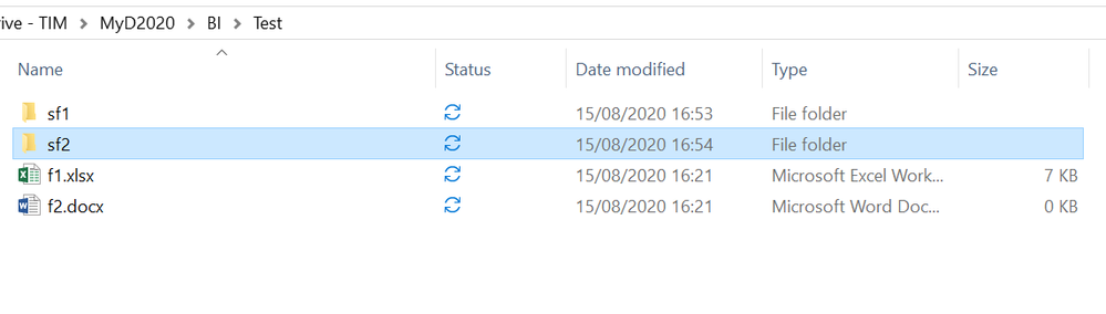

it is just a guess, but try if this is a good starting point:
   dirall=(path)=>
    Source = Folder.Contents(path),
    dir=List.Accumulate(Table.ToRows(Source[[Content],[Name]]),{},(s,c)=>if Value.Is(c{0}, type table) then s&@dirall(path &"\"& c{1})  else s&{c{1}} )
    in dir
    dirall
this function recursively goes through all the folders and subfolders of a directory and supplies only the name of the files.
but only you know what else to do with these files
here a version that add some action to the files.
   dirall=(path)=>
    dir=List.Accumulate(Table.ToRows(Source[[Content],[Name]]),{},(s,c)=>if Value.Is(c{0}, type table) then s&@dirall(path &"\"& c{1})  else s&{[name=c{1},len=Text.Length(Text.BeforeDelimiter(c{1},".")) ]} )
    in dir
    dirall
for each files name the last number is the number file in the subfolder.
f212 for example is the second file in the filder f21 which is the first subfolder of folder  f2 wich is the second subfolder of folder "test"
may be this could be more usefull to your goal
   dirall=(path)=>
    dir=List.Accumulate(Table.ToRows(Source[[Content],[Name]]),{},(s,c)=>if Value.Is(c{0}, type table) then s&@dirall(path &"\"& c{1})  else s&{path & "\"& c{1}} )
dir
    dirall
having all the files with complete path you can apply your function (I suppose)
in the following form it is probably easier to understand
  dirall = (path) => List.Accumulate(
      Table.ToRecords(Folder.Contents(path)),
      (s, c) =>
        if Value.Is(c[Content], type table) then
          s & @dirall(path & "\" & c[Name])
        else
          s & {path & "\" & c[Name]}
  dirall
