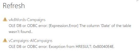

I successfully connected to my Google Sheets data using this connector yesterday. However, when I'm hitting refresh I get the following error messages:
No columns have changed in my source data, except that new rows got added. How can I resolve this issue?
- jkaemmerlingFrequent Visitor
Is the sheet connected to a form?
Is the column renamed in the source file?
Did anything happen to the source file that would change title, position or structure of column?
Also how many rows in the google sheet?
Open the "Advanced Editor" in Query Editor and double check all of your syntax and see if any changes are being applied to that date column in the query.
Last piece of advice which usually yields results for me: walk backwards step-by-step of all your data prep steps and see if you can deduce a pattern or where the error ocurred. Usually the errors are so miniscule us humans miss them.
