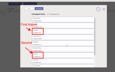

I have a datasource I'm using to load data into a Dataverse table but am finding it creates duplicate records with each import since the original records still exist in the source table. What is the best way to prevent the creation of duplicate records?
Here's an example with some sample data:

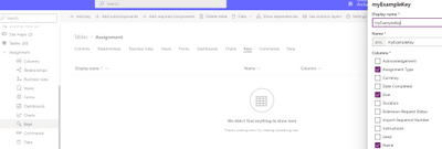

        To set one up, just navigate to the table you want to configure in the make.powerapps UI and you'll find Keys in the left nav. Select that, then create a new key, and you can then select all the columns you want to use as a composite to form a unique key. For example, in the screenshot below, I have a table called Assignment and I am creating a key that enforces uniqueness by a combination of Name, Due, and Type:
        As far as linking them together with your import, that's actually the easy part! Dataflow automatically detects that there is a Key associated to the table you are importing and takes the field mapping you provide to build that key and validate it against what is already in the table. If the key for the imported row already exists in the table, Dataverse does an Update, otherwise it Inserts (and you don't need to set up any of the logic - it just works!)
