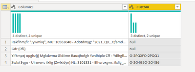

Here is a sample:
Rakflhmjfl: "Jywmkq", MU: 10563048 - Adotdmyg: "2021_QJL_QfamdApoHdxgnz_ApkmaNdnnmgf_QJU_ATT_Txwq_QA", MU: 26167032 - Cff: NMUOJ RU EOBNMIF
Gdr (0%)
Ylfkmpxj opghz(j) Mgkdwma Gldiimn Rauxjhofgh Ywdhiplo Cff - Ydlhgfl: damadj (Qfamdnpo) MU: 3101331 - Rakflhmjfl: damadj_IR_Umjtwdq_AR MU: 3245736 - Adotdmyg: damadj-OQ^Iplhz-fApo-Umjtwdq-Ipgf-Bfhdlyfhmgy -ARRwbdqj_ Jg-2104- Afwhld K2 YZV RUM RUY 26 O-2PQXF O-2PQQ1 MU: 5956202 - Mgjflhmpg Jlafl: YZV | BJI | Raxwhj 18+ | Alpjj Ufkmnf | AYQ | Afwhld | UN 360 | Idhmpgdw | Bfhdlyfhmgy Y1QYI59 O-2PQXF O-2PQQ1 MU: 19199044
Zwlxi Sygo - Uirovwr: ilxlig (Zwlxidyn) NL: 3101331 - Elfwroxgwr: ilxlig_BE_Lxgpbis_SE NL: 3245736 - Sinpixqv: ilxlig-BE-wSyn-Lxgpbis-wSynnwrdw-Iwoirqwoxvq-SEEbaisgXv- 2107-13140-Zjboxpbw-O3 UGJ ELN ELU 029 O-2O4G5 O-2O4G5 O-2O4G6 NL: 6703113 - Nvgwroxyv Xrlwr: UGJ | IXB | Eljbog 18+ | Srygg Lwfxdw | SUZ | Swbori | LM 360 | Bioxyvib | Iwoirqwoxvq U1OL28O O-2O4G5 O-2O4G6 NL: 21408844

"O-xxxxx" - total of 7 characters, starting with "O-'. Sample has 4 records, two of them don't have order numbers, i need unique order numbers only.
@Vladisam  there you go
    Source = Web.BrowserContents("https://community.powerbi.com/t5/Power-Query/Extraction-of-multiple-7-characters-text-substrings-starting/m-p/2117172#M62409"),
    #"Extracted Table From Html" = Html.Table(Source, {{"Column1", "DIV[id='bodyDisplay_8'] > DIV.lia-message-body-content > TABLE:nth-child(3) > * > TR > :nth-child(1)"}}, [RowSelector="DIV[id='bodyDisplay_8'] > DIV.lia-message-body-content > TABLE:nth-child(3) > * > TR"]),
    #"Changed Type" = Table.TransformColumnTypes(#"Extracted Table From Html",{{"Column1", type text}}),
    fx = let   fx =(input)=>
    Web.Page(
        "<script>
            var x='"&input&"';
            var b = x.match(/O[-][0-9A-Za-z]{5}/gm);
            document.write(b);
        </script>"){0}[Data]{0}[Children]{1}[Children]
    fx,
#"Added Custom" = Table.AddColumn(#"Changed Type", "Custom", each fx([Column1])),
    #"Expanded Custom" = Table.ExpandTableColumn(#"Added Custom", "Custom", {"Text"}, {"Text"}),
    #"Added Custom1" = Table.AddColumn(#"Expanded Custom", "Custom", each List.Distinct(Text.Split([Text],","))),
    #"Extracted Values" = Table.TransformColumns(#"Added Custom1", {"Custom", each Text.Combine(List.Transform(_, Text.From)), type text}),
    #"Removed Columns" = Table.RemoveColumns(#"Extracted Values",{"Text"})
    #"Removed Columns"

Bingo!
Thank you so much!! RegEx made it to the top of my "Learn Next" list!
Can you pleasee comment on how code works (from "fx = let" down)?
@Vladisam  sorry coluld not reply you earlier.
For the fx part, I have written a custom function using js script to be invoked later in the PQ later. I wrote a blog post earlier which gives you a basic understanding of how JS can run in PQ.
https://community.powerbi.com/t5/Community-Blog/How-to-use-JavaScript-inside-power-query-for-data-ex...
I am planning to write the next series of this on regex extraction soon.
Inside fx, I am using JS match function where you can pass on regex expression
https://developer.mozilla.org/en-US/docs/Web/JavaScript/Reference/Global_Objects/String/match
 like following
<string>.match(regexp)
and it matches all instances of qualified patterns defined by the user in the string.
