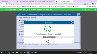

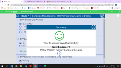

Below is picture-1, which is navigating to next equipment after saving response of one equipment. this is the screen which i got from running app normally.
But if i run the app through deep linking then on same page after filling response, i am not navigated to required next screen, instead it is navigated to Scrn_checklist
