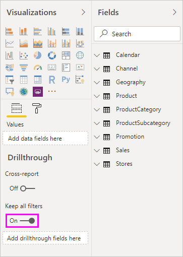

You can pass all applied filters to the drillthrough window. For example, you can select only a certain category of products and the visuals filtered to that category, and then select drillthrough. You might be interested in what that drillthrough would look like with all those filters applied.
To keep all applied filters, in the Drillthrough section of the Visualizations pane, set the Pass all filters toggle to on.
