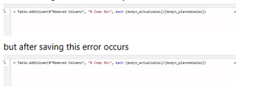

I am new to powerbi especially in using power query add custom column. I need help what would be the correct formula for this. I have to divide the actual sales field to the planned sales. Tried creating one there is no syntax error
but after saving this error occurs
How did you manage this error?
Thank you
Hi @juhoneyighot ,
The Error: Divide by zero error encountered means the divisor you are using, i.e. column msdyn_plannedsales, has a value of 0 or a null value. And in math calculations the divisor can't be 0.
Here is my sample data:
Please change the M function into this:
if [plannedsales] = 0 or [plannedsales] = null then "There is no plannedsales" else [actualsales] / [plannedsales]
You can change the content of "xxx" by yourself.
And the final output is as below:

And @juhoneyighot , the two screenshots you put up are the same, what exactly is the Error you are experiencing? Can you resubmit the screenshots?
In addition, your M function has been tested and there is no problem itself, so there may be a problem with the structure of your data, if you can please provide a sample data, thank you!

I'm sorry for that. Here is the error.
Hi @juhoneyighot ,
Dino Tao
