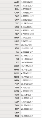

The issue with this is that i need every currency type converted to USD, EUR, and SEK.  This last screenshot is the entire output it is giving me (not even close to complete).
I just need a table with 3 columns.  To, From, Rate
ex......   USD, EUR, 1.25
