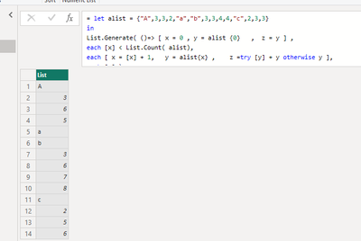

Cumulative list that re starts when a text value is encountered.
Using  list.Generate, and having the list start with and contain text ,   i have come up  with this
but woudl be interested in other ways espcially if try could be avoided and replaced with a let  statement ;
let alist = {"A",3,3,2,"a","b",3,3,4,4,"c",2,3,3}
List.Generate( ()=> [ x = 0 , y = alist {0}   ,  z = y ] ,
each [x] < List.Count( alist),
each [ x = [x] + 1,   y = alist{x} ,    z =try [y] + y otherwise y ],
each [z] )

lbendlin
Shouldn't the result for row 4 be 8 ?
Try this,
let alist = { "A",3,3,3,"a","b",2,3,4,3,2,"c",2,3,3,3}
List.Generate( ()=> [ x = 0 , y = alist{0} ] ,
each [x] < List.Count( alist) ,
each [ x = [x] + 1, y = try [y] + alist {x} otherwise
alist{x} ] ,
each [y] )
