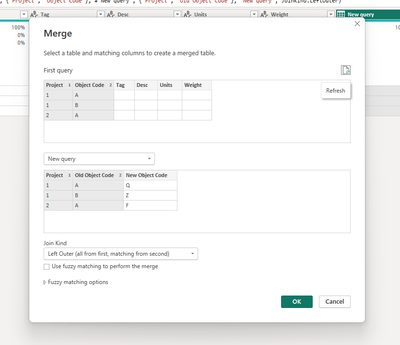

I think the simplest way to go about this would be to just Left Outer merge your New Query (NQ) onto your First Query (FQ) on FQ[Project] and FQ[Object Code] = NQ[Project] and NQ[Old Object Code].
You can do a two-field merge by using Ctrl+click on the fields in the merge dialog. Make sure to Ctrl+click the fields in the same order on each table:

if i understood you want to get in the first table the new object code
you need to merge the first query this way
then expand this way
and you get this

Hi Jsaidtecnimont ,

I think it is not a problem. Once you have merged you create a conditional column that gets the new or the old object code based on your type of object
