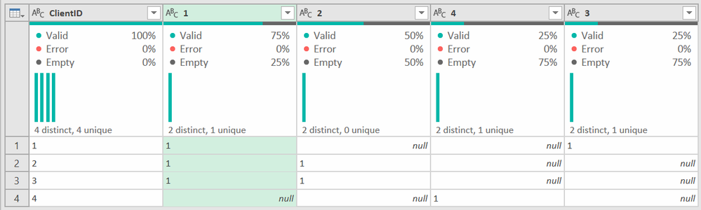

      That said, see if this works. It pivots your Product ID column and aggregates using the MAX function.
          Source = Table.FromRows(Json.Document(Binary.Decompress(Binary.FromText("i45WMlTSgeJYnWglIxSeMZBlhCJnhCKHUGkCZJnAeSBxYxQeVGUsAA==", BinaryEncoding.Base64), Compression.Deflate)), let _t = ((type nullable text) meta [Serialized.Text = true]) in type table [ClientID = _t, #"ProductID " = _t, Value = _t]),
          #"Pivoted Column" = Table.Pivot(Source, List.Distinct(Source[#"ProductID "]), "ProductID ", "Value", List.Max)
          #"Pivoted Column"
      I would need to know more of your data to know if this makes sense though. Generally do you NOT want to denormalize your data in Power Query like this. It makes subseqent DAX harder as a rule, but that is from my perspective here, not in your seat with your entire project laid out before you.

        Thank you edhans ,
        I pasted your code and I got that result but this is just a sample.
        Can you help me to adapt the code to my data?
