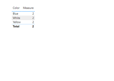

    You can create a measure
    Measure = COUNTROWS(FILTER('Answer',CONTAINSSTRING([Answers],MAX(Color[Color]))))
    Then put the color field and the measure to the table visual, and in visual field, set the following filters:
    Output
    Best Regards!
    Yolo Zhu
