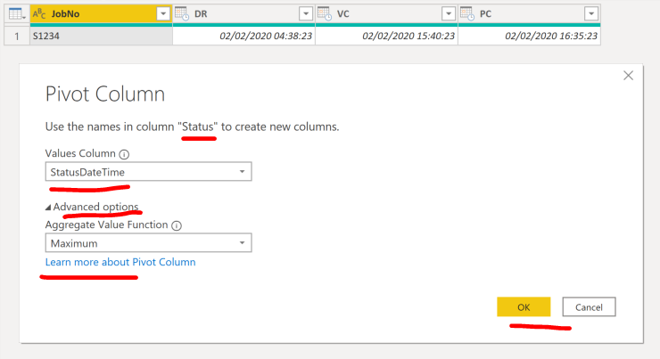

    Hi Anonymous
    You can pivot your Table B with the setup as below.
    Later just Merge the tables on JobNo
    Also, see the attached for the ref.
